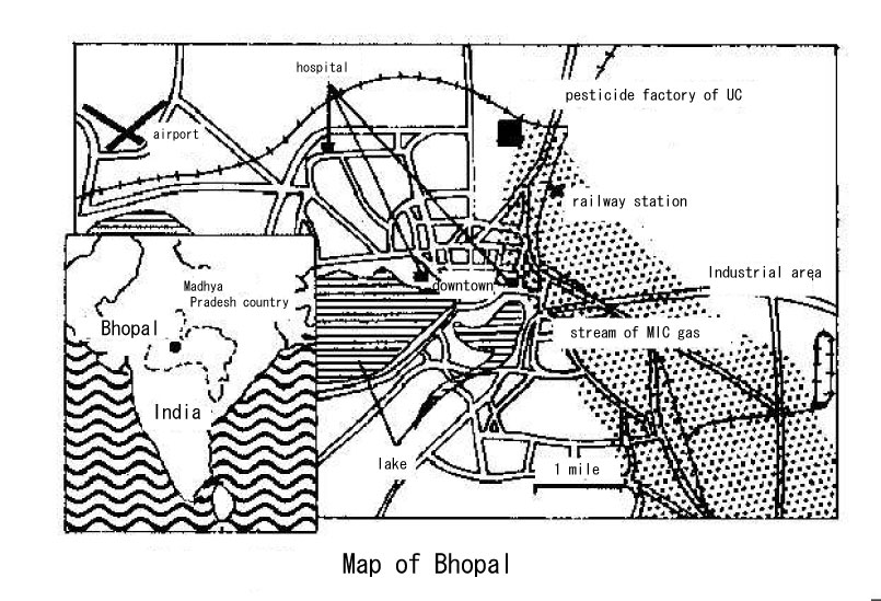

From a storage tank of a chemical firm in Bhopal, which is in central India, methyl isocyanate (MIC), which is a deadly poison and an intermediate of a pesticide, leaked at night. Carried by a northwest wind, the leaked MIC gas diffused over the city and spread on the ground. No countermeasure was taken against the diffusion of toxic MIC gas because there was no previous warning and it occurred suddenly at night. Many citizens could not take refuge and received injuries. Refer to Fig4. |

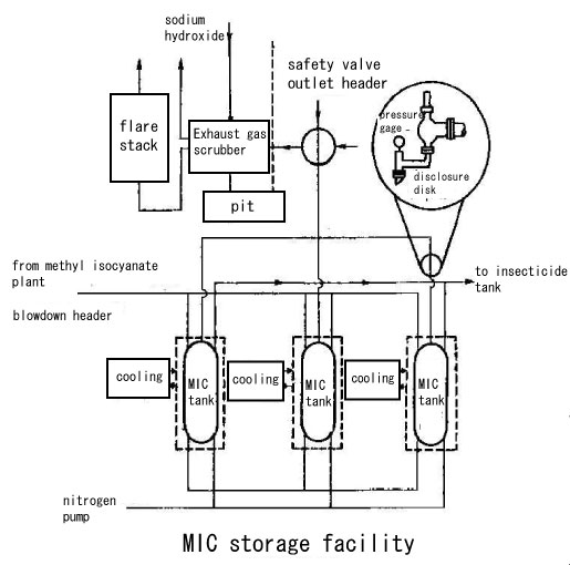

Fig2.Unit process flow

The trigger that caused toxic MIC gas to be diffused was an error in the work and a mistake in operation of distillation on-stream, as described in the column "cause." Although the new operation manager directed inadequate work, the error was due to not only the manager but also operators. Three kinds of safety equipment had been installed in the storage tank, and all of them had been stopped on the day. The boiling point of MIC was low, and it should be maintained below 0 °C to avoid evaporation. However, the refrigerator which was installed for cooling had been stopped since June. There was an opinion that it had been stopped to save energy. MIC gas evaporated and went outside the tank to the vent gas scrubber where MIC gas was absorbed by alkali during usual operation. However, the scrubber had also been stopped since October 22nd when the plant was shut down. The flare stack that burns all leaking gas, which is the final piece of safety equipment, had also been stopped for piping work. In short, there seems not to have been a consciousness of safety, while deadly poison chemicals of MIC were being handled. The leaking of water was also due to the same cause. When the background is viewed, the pesticide that was the final product of MIC was being replaced with a pesticide of a different type. Therefore, the MIC factory was incurring a deficit, the company including the parent company did not make new investments, and the company did not pay attention to employees' safety, education, and training. Due to such a condition, the morale of the employees fell, and discipline became lax. Previous accidents had also happened, but their lessons were not used either. The irresponsibility of the parent company, which had given up its social responsibility to produce and store the deadly poison MIC, and the subsidiary, which was in charge of the operation, seems to be a basic cause. This disaster is a typical example in which hazards management was completely lacking. |

Effluent gas diffused over about 40 square kilometers in a southeast urban district. Flora and fauna were also damaged. Many victims suffered from sequelae. |

Fig4.Figure showing damaged area
