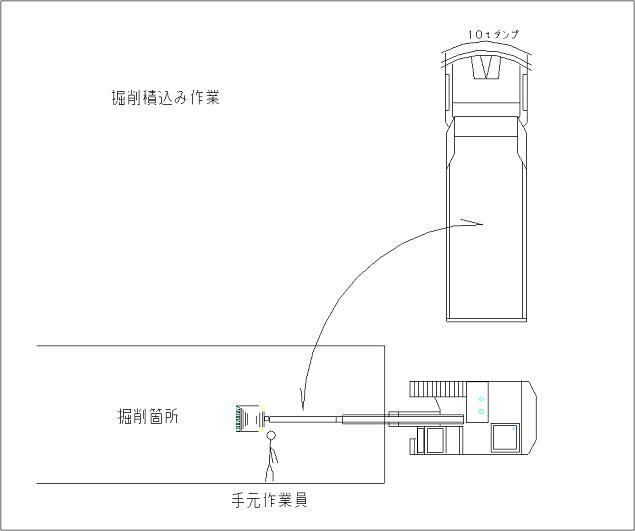

The dump truck backed in order to carry the mining surplus soil while the heavy equipment and the worker did the bedded work in order to install the drainpipe, and the mining surplus soil was loaded to the dump truck. When the operator turned the backhoe at the bedding place in order to start the mining and bedding work then, the assistant woker was almost hit the bucket of the backhoe.It was the Near Miss case. |
The bucket of turning backhoe was almost hit the assistant worker. |
The dump truck backed in order to carry the mining surplus soil while the heavy equipment and the worker did the bedded work in order to install the drainpipe, and the mining surplus soil was loaded to the dump truck. When the operator turned the backhoe at the bedding place in order to start the mining and bedding work then, the assistant worker was about to be hit by the bucket of the backhoe, and the operator immediately stopped turning and avoided the hit. |
* The operator turned it without confirming the safety of mining and bedding place. * The operator had not thought that the worker was at the mining and bedding place. * In the turning start position, the operator on the driver's seat could not see the worker. * The worker did not think that the backhoe turned. * The worker thought that the operator of the backhoe had noticed the worker. * They worked without posting guards for the heavy equipment work. * They each forgot KY in the morning. * The operator turned withoutpointing workers and calling their names. * They did not establish the measuure of stopping entering into heavy equipments' turning range. |
* The heavy equipment operator should carry out strictly cpointing workers and calling their names. * The worker should not enter into heavy equipments turning range. |
* Wokers should be taught so that they may not enter into heavy equipments turning range when heavy equipment was operated. * They should establish the measuure of stopping entering into the heavy equipment's turning range. * They should confirm the safety of the work range, when it is newly started. * They should strictly enforce one person KY if the contents of the work change. * They should strictly carry out pointing workers and calling their names. |

Fig2.Mining and loading work
