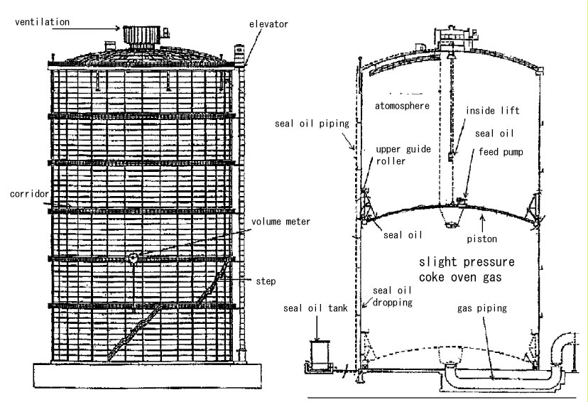

When a dry-type 100,000 m3 coke oven gas (COG) holder was repaired at an ironworks, another dry-type 40,000 m3 holder was used. The 40,000 m3 holder exploded. Grease, which was a lubricant of pistons in the holder, ignited and burned. This explosion resulted in the following damage: the 100,000 m3 COG holder, 100,000 m3 blast furnace gas (BFG) holder, and factory buildings were damaged. 15 persons were injured in the blast. In addition, nine days later a fire occurred during hot work to cut off a side plate of the 100,000 m3 COG holder, which was under inspection. |

From August 30th to September 11th, 2003, a 100,000 m3 COG holder was scheduled to be inspected and repaired. A 40,000 m3 holder was substituted. About 19:42 on September 3rd, the 40,000 m3 COG holder exploded and was destroyed by fire. 03:26 on September 4th, the fire was extinguished. About 10:50 on September 12th, a fire occurred at the 100,000 m3 COG holder. 12:40, the fire was extinguished. |
Disaster Management Agency stated in its home page dated 09:15 on September 4th that the first explosion and fire occurred due to a reaction of carbon monoxide with oxygen in the holder. The second fire was caused by ignition of a rubber seal of the tank on cutting the side plate, and the fire spread when grease ignited. |

Fig2.Tank construction plan
