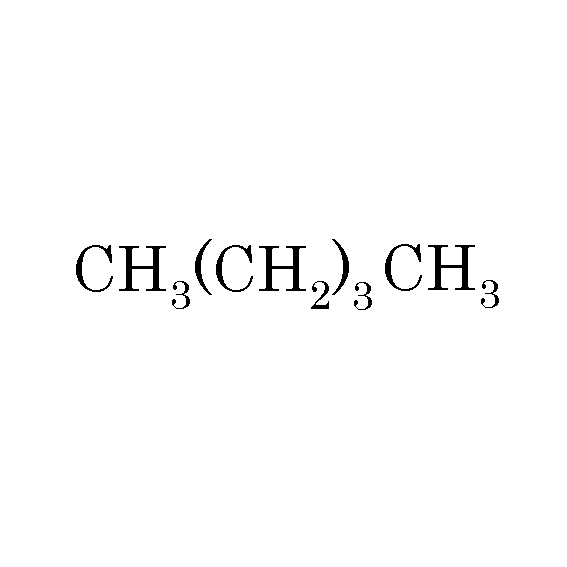

    | Pentane, Fig3 |

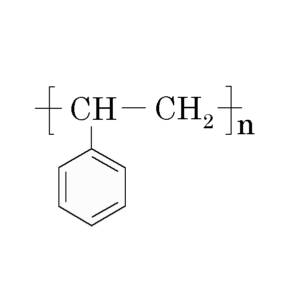

    | Polystyrene, Fig4 |

    | Fig3.Chemical formula |
    | Fig4.Chemical formula |
