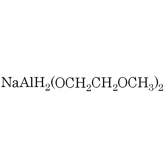

Sodium bis (2-methoxyethoxy) aluminum hydride. Fig.2 |

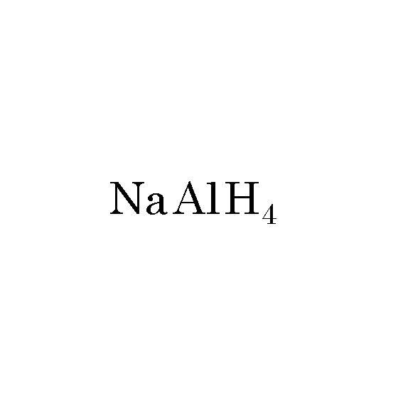

| Sodium aluminum hydride, Fig.3 |

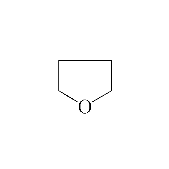

| Tetrahydrofuran. Fig.4 |

Fig2.Chemical formula
Fig3.Chemical formula
Fig4.Chemical formula
