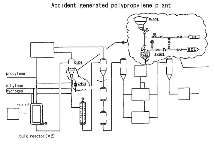

Fig2.Unit process flow

A worker opened an air driven automatic valve of a degassing tank on the fifth floor to collect samples of polymer products in the reactor during usual operation. At that time, a fire occurred at the lower part of the sampling pot on the fourth floor. At this stage, the lower valve of the sampling pot on the fourth floor which should have been closed was open. (refer to Fig2) Degassing drum: A vessel installed at the polymerization reactor outlet to separate polypropylene particle products from the gas containing unreacted propylene gas. Sampling pot: A small vessel installed beneath the degassing tank for sampling. |
At the reactor outlet, polypropylene particles coexisted with unreacted propylene gas. By separating the gas and the polymer particles in the high-pressure degassing drum, the polymer particles were removed at the bottom to the sampling pot with unreacted propylene gas. Then the mixture was depressurized and the gas was purged before sampling. In the sampling procedure, confirmation that the sampling valve was closed at the bottom of the sampling pot, which is the last task for preparations before sampling, was neglected. As the sampling valve was left open, polypropylene resin and propylene gas passed through the sampling pot from the degassing drum and spouted out through the sampling valve and the open inlet valve of the sampling pot. It is considered that the mixture was ignited by static electricity in the gas flow. |
As an initial measure, emergency shutdown operation was done from CCR. In the field, water sprinkling with fixed fire fighting equipment, separation work, and nitrogen filling were carried out. In addition, water showering for cooling was carried out by 28 fire fighters and a disaster prevention crew using a high-place-pour-water engine and a chemical fire engine. CCR: Central Control Room, a main instrument room or a control room of the plant. |
Review of the reporting system to prevent a delay in reporting. Improvement in the structure so that the bottom valve of a degassing drum cannot be opened while the valve at the lower part of the sample pot is closed. |
