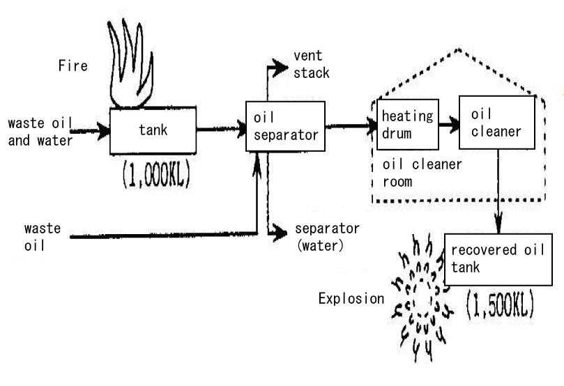

At a factory that regenerated waste oil from a tanker, usual operation was performed and stopping procedure was underway. An explosion occurred on stopping. Waste oil, which was a mixture of oil and water from a tanker, was transferred to an indoor open tank via a water-oil separator. Then, regenerated oil flowed into a recovery oil tank after warming and cleaning as usual. After finishing the operation, the power switch was turned off. Then an explosion and fire occurred. A 1000 kL outdoor recovery oil tank and a 1500 kL outdoor recovery oil tank also exploded and caught fire. Although gas generated at the water-oil separator was discharged from a vent stack of 30 m high, there is no record of the facilities that discharge the combustible gas generated at a heating drum, etc. in the building. |

Fig2.Unit process flow

The content of light components was high in the waste oil that was treated on the day. It was heated to 70 °C in an open heating drum as usual. Therefore, in the heating drum or a downstream process, a large volume of combustible gas was generated, and it filled the inside of the factory building. As the work was done in daytime only, an explosion and fire occurred due to an electric spark on turning off the power supply switch at the end of the work. Although a large volume of combustible gas was generated, the employees did not seem to take any measures. The details are unknown because the persons working at the site died. Poor management of a combustible gas and use of non-explosion-proof type electric devices were direct causes. |
