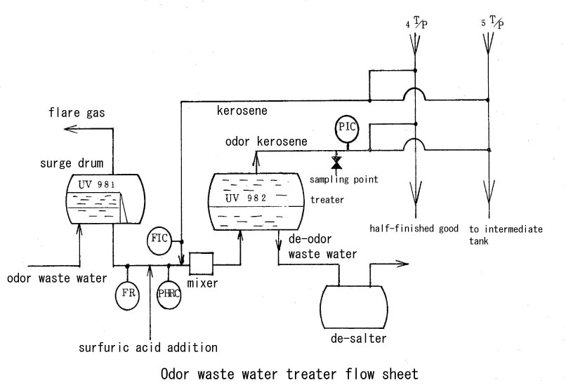

A full-surface tank fire occurred at a 22000 kL kerosene tank in a refinery. Straight run kerosene from an atmospheric distillation unit flowed into the tank via an odor water treatment unit. At the time of the accident, the tank was operated as usual. Odor water treatment unit; an in-house development unit. By mixing odorous waste water and straight run kerosene, odor components such as hydrogen sulfide are extracted and transferred to the kerosene. Naturally corrosive substances such as hydrogen sulfide are contained in the kerosene from odor water treatment equipment. |

| Process Flow |
Fig2.Unit process flow
