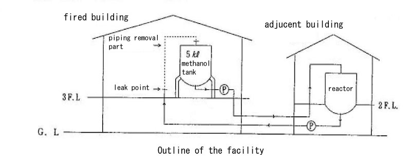

At a plastic glue manufacture plant, methanol was returned as usual from a reactor to a methanol tank. However, the piping was removed accidentally and a joint was opened. Methanol flowed out, was ignited by neighboring welding sparks, and there was a fire. Refer to Fig2. |

Fig2.Sketch of the facilities

On December 21st, 1991. The person in charge of construction directed the revamping for equipment extension. At this time, he accidentally ordered that the wrong piping should be removed. Consequently, necessary piping was removed. About 11:30 on December 26th. The pump started to return 1500 L of methanol in the reactor to the methanol tank for washing. The tank was temporarily used for revamping. Methanol flowed out of an open joint (100 L per minute). Methanol arrived at a welding site about 4 m apart. It was ignited by welding sparks, and a fire occurred. As initial firefighting with a fire extinguisher was not successful, a foam extinguishing system started after employees evacuated. 11:42. The fire was extinguished. 11:43. The fire was reported to the public fire fighting department by an emergency call. |
