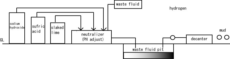

An explosion and fire occurred at a waste treatment unit of an aluminum container-manufacturing plant. Strong acidic aluminum waste liquid was processed in a pH adjust vessel and then, sent to a waste liquid pit. The amount of waste liquid was beyond the capacity of the pH adjust vessel. Therefore, a large amount of hydrogen was generated in the pit, and it caused a fire and an explosion. |
An explosion occurred at a waste treating unit in a plant where aluminum cosmetic containers were manufactured. Strong acidic aluminum waste liquid containing sulfuric acid and aluminum powder was generated in the aluminum oxide(Al2O3) processing device, went through the pH adjust vessel and flowed into the waste liquid pit. Then, an explosion occurred in the pit. Reaction formula of neutralization is shown in Fig3. |

Fig2.Unit process flow

Strong acidic aluminum waste liquid containing sulfuric acid and aluminum powder was supplied to neutralization processing. The liquid from the neutralization vessel flowed into the next waste liquid pit. An explosion occurred suddenly in the waste liquid pit. |
The waste liquid flow rate was above the capacity of the pH adjust vessel, because too much waste fluid flowed. Then, the fluid flowed into the next tank before neutralization was completed. Therefore, a large amount of hydrogen was generated from the reaction of aluminum and sulfuric acid; it leaked from a hole in the waste liquid pit, was ignited by sparks from the time recorder, and caused a fire and an explosion. |
