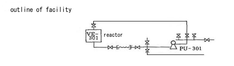

Fig2.Unit process flow

Dodecylbenzenesulfonic acid was charged by a pump. Alkylamine was also charged. pH was at 8.8. Dodecylbenzenesulfonic acid was added. Hydrogen peroxide water (60%) was charged by the same pump. An explosion occurred near the pump. A fire did not break out at that time. |
It is a decomposition explosion of hydrogen peroxide. Hydrogen peroxide had to be charged from the upper part of the reactor, but it was charged by the pump supplying dodecylbenzenesulfonic acid. The hydrogen peroxide possibly reacted with iron rust and others in the pump and caused a rapid decomposition reaction. |
