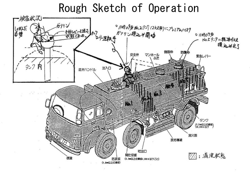

The lorry driver continued loading to the lorry tank which was full of gasoline, because he was convinced that he had switched to another tank of the lorry. Therefore, the anti-overflow system operated. However, the driver and the control room operator did not confirm the situation, and judged it was a malfunction. The control room operator reset the alarm, the driver opened the anti-overflow valve by hand, and the loading was continued. As a result, gasoline leaked through the clearance of a loading arm seal and a tank manhole, and injured the driver. Damage was minimized, because the operator released the loading arm, enforced release of the anti-overflow valve was canceled, and loading was arrested again. |
When loading of gasoline into No. 2 tank of the tank lorry had been completed, the loading tank had to be changed to No. 3 tank. However, the tank lorry's driver forgot to switch to No.3 tank. Naturally, over-loading instrumentation functioned, an alarm sounded, and an anti-overflow valve closed. The driver and a control staff of the lorry station judged the alarm to be malfunctioning without confirming the situation. The control staff in the control room reset the alarm, and the driver temporarily released the arrested anti-overflow valve by hand, and continued loading. As a result, 1 or 2 L of gasoline leaked through the clearance between a loading arm seal and a tank manhole. Gasoline entered the eyes of the lorry driver, who was injured slightly and went to hospital for seven days. Refer to Fig2. |

At 10:59 on July 23rd, 1994, the lorry driver was instructed about loading at reception of the control room in the lorry station. At 11:09, loading to No. 5 tank of the tank lorry finished, and loading to No. 2 tank (for 2 kl ) started. At 11:11, as loading to No. 2 tank finished, the driver should have switched the loading tank to No. 3. At 11:12, the driver forgot to switch to No.3 tank, and started loading to No. 2 tank again. A mechanical anti-overflow valve mounted at the loading arm operated, and the flow was cut off. Simultaneously, the alarm system operated at both the control room and the lorry station. A buzzer sounded, an alarm lamp lit, and the flow control valve shut. The control staff was convinced that a malfunction had been caused due to a very small leakage, although he confirmed that the alarm lamp was flashing. He reset the abnormal alarm system and turned off the light of the alarm system. At the same time he asked a lorry station's field operator to check the tank level with the paging system. At 11:13, the lorry driver judged that there was a malfunction of the alarm system. After he confirmed the alarm lamp was off in the control room, he ontinued loading with making anti-overflow valve open with his hand. Therefore, the gasoline blew out through the clearance between a loading arm seal and a tank manhole, and he injured his eyes. The enforced release of the anti-overflow valve was canceled, because the driver let go the anti-overflow valve, and the alarm system operated again, and loading of gasoline automatically stopped. |

Fig2.Rough Sketch of Operation
