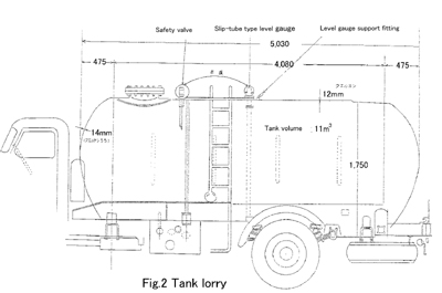

Five-ton tank truck (inside diameter: 1,750 mm, length: 5,030 mm, barrel thickness: 12 mm, material: 60 kg class high strength steel) (See Fig. 2) |

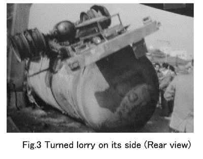

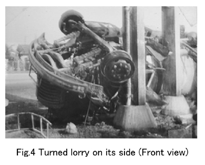

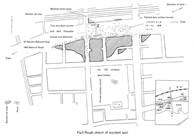

During the nighttime of October 26th, 1965, a five-ton tank truck running on a national highway in Nishinomiya City overturned due to the improper steering by the driver who fell into a doze while driving. Sustaining a shock from the overturn, the safety valve and the slip tube level gauge protruding from the top of the tank truck were broken and caused LP gas to blow out. The spilled LP gas diffused into approximately 1m thick white fumes, which crawled ahead across the range of 200 m along the national highway. About five minutes later, LP gas ignited from an unknown source. Numerous ignition sources are conceivable, but the real one is still unknown. This fire resulted in a great disaster causing 5 deaths, 26 serious and minor injuries, and 31 residential destructions. The estimated amount of damage was 120,000,000 yen. The carrier company could not afford to compensate for the total amount of damage, thus causing the compensation negotiations to proceed slowly. |
During the evening hours, a five-ton tank truck running on a national highway in Nishinomiya City, Hyogo was overturned due to the improper steering by the driver who fell into a doze while driving. (See Figs. 3 and 4) The tank truck, which was estimated to be running at a speed of 60 km/h or more, overturned just before the pedestrian overpass, slid away about 8 m, and crashed against the support of the overpass. Sustaining a shock from the overturn, the protruded safety valve (size 50A) and slip tube level gauge were damaged. Given a shock such as this, a safety valve of any material would break down in this situation. The tank truck struck the curb, causing the right side of the truck (seen from the loading position) to be dented 110 mm deep, 1,200 mm long, and 600 mm wide. However, no areas were found where LP gas leaked, and no marked abnormalities were identified in the other fittings, either. The gas blown out from a rupture (50A/19.6cm2) kept spreading, ignited, and exploded about five minutes after the initial blowout. Assuming that the LP gas freely escaped from the hole, most of the LP gas escaped in about five minutes before the inflammation. The escaped LP gas developed into about 1 m thick white fumes, which crawled ahead across the range of 200 mm along the national highway. (See Fig. 5) Part of the fumes filled the southeast area of the overpass and went downwind beyond a wall (about 2 m high) into the neighboring residential area. This was also identified by the fact that the concrete-block wall fell down toward the sidewalk. The LP gas diffused in such a wide range that numerous ignition sources were conceivable but none of them has been identified as the real one. Yet, the possible inflammation sources could be narrowed down into: (1) Inflammation sources in the neighboring private residences (such as thermostat of electric refrigerator, pilot lamp of gas range, motor of an outside home pump, or embers in an incinerator); (2) fire sparks from exhaust fumes of running vehicles; and/or (3) the engine or electric sparks from the tank truck. |
