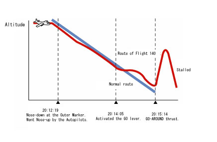

    | Sequence | (1) China Airlines Flight 140 aircraft approaching the Nagoya Airport passed the outer marker (the radio beacon furthest from the runway) at 20:12:19, and started landing. (2) The pilot was performing a normal ILS approach (ILS guides an approaching airplane to enter the runway using radio waves) to the runway. At 20:14:05 the copilot mistakenly triggered the GO lever (a lever that maximizes engine thrust for take-off or GO-AROUND) and the plane entered the GO-AROUND mode and increased its thrust. The captain cautioned the copilot that he had triggered the GO lever, and instructed him to disengage the GO-AROUND mode. This thrust increase lifted the aircraft off the regular path.
 (3) The captain instructed the copilot to lower the course, and the copilot operated the control lever in the direction to lower the nose. He also activated the auto-pilot in an attempt to engage the auto-landing mode. The GO lever, however, kept the plane in GO-AROUND mode and the tail wing elevator (stabilizing plate) moved against the copilot's operation to lower the nose and suddenly move in the other direction to lift the nose. The autopilot computer was simply trying to execute GO-AROUND. The captain repeatedly instructed the copilot to descend, and the copilot acknowledged it, however, the horizontal stabilizers were at their other limits to lift the nose. The Autopilots were disengaged at around 14:50.
 (4) The aircraft kept climbing with its pitch angle in the nose-up direction. After 14:57, the stall prevention system, Alpha Floor function activated to prevent a stall. The function maximized the thrust and the plane further pitched upwards. The captain took over controls at 15:03 but the aircraft's pitch angle continued to increase above 10 degrees.
 (5) At around 15:14, the captain then gave up landing notified Nagoya tower that he will "GO-AROUND."
 (6) The increase in the thrust, however, with the horizontal stabilizer at its full up position further turned the plane up. The pitch angle eventually reached 53 degrees and the aircraft stalled and crashed at around 15:45.

    | Multimedia Files | Figure1.Descent path of China Airlines Flight 140 |
