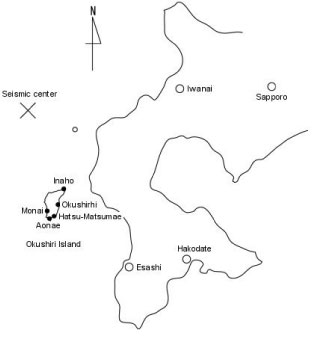

At 22:17 on July 12, 1993, an earthquake occurred southwest (at latitude 42.47 north and longitude 139.12 east) of Hokkaido in the Sea of Japan. The powerful 7.8 magnitude quake had its epicenter at a depth of about 34 km on the sea floor very close to the Okushiri Island (Figure 1). The island was hit by a tremor measuring 6 on the Richter scale (estimated because the island did not have a seismograph). At around 22:20, the first wave of the tsunami struck the island, sweeping away many people and homes (385 homes out of 504) in the Aonae district of the island. Structures of 190 homes remaining after the wave attack were destroyed by the fires that engulfed the area (total 51,000 meters squared) due to broken gas lines and toppled fuel containers. The quake triggered a mudslide in the Okushiri district of the island, sending a huge chunk of mud and rocks onto a hotel. The mudslide killed 29 people including the guests staying at the hotel. At the northern tip of the island, the tsunami waves swept the Inaho district, taking 70 homes. About 5 minutes after the quake at 22:22, the Sapporo District Meteorological Observatory issued tsunami warning. Among the tsunami waves that struck the coastal towns of the Sea of Japan, the ones that hit the Okushiri Island were the strongest. Waves reported variously as being between 6.7 and 30.6 meters in height swept through the coastal areas: 8.5 m in Inaho, 3.5 m in Okushiri, 16.8 m in Hatsu-Matsumae, and 6.7 m in Aonae. In the Monai district located west of the island, the wave height reached 23.2 m at the high-pitched river mouth, and 30.6 m at the inland riverfront. The highest inundation height of 11 m was observed in the west part of the island, and the lower one of 5 m in the east part of the island. The disaster caused considerable damages including earthquake cracks, subsidence damage, destroyed structures, liquefaction of ground, and leakage of kerosene from toppled fuel containers. The tsunami waves also struck the west part of the Oshima peninsula (located in Hiyama, Hokkaido) and Tohoku prefectures. Photo 1 shows the devastated fishing port of Aonae, and Photo 2 the landslide in the Okushiri district. People in the Okushiri Island had experienced a tsunami generated by the Japan Sea earthquake 10 years before, in which the tsunami struck the island 20 minutes after they felt shocks beneath their feet. 7% of the island's population, who assumed that tsunami would not reach the shore so soon, took time to evacuate and failed to escape from the waves. The waves propagated to the island in approximately 3 minutes, which allowed enough time for the healthy young to run or cycle and evacuate safely to an elevated inland location. In response to the 1993 tsunami, 6.6 m-tall artificial ground facilities was created at the port of Aonae as evacuation and communication routes leading to an elevated inland location. |
A powerful 7.8 magnitude earthquake occurred southwest (at latitude 42.47 north and longitude 139.12 east) of Hokkaido in the Sea of Japan. Because the quake had its epicenter at a depth of 34 km on the sea floor very close to the Okushiri Island, the tsunami struck the island in less than 4 minutes after the tremor, leaving no time for the people of the island to evacuate. The massive tsunami swept across the island, destroying homes and towns in an instant. It caused the most of the casualties. The location of many homes by the seaside contributed to high toll of victims. |

Figure 1.Seismic Center of Southwest-off Hokkaido Earthquake
