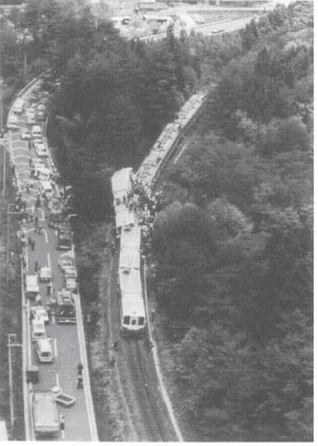

The JR West special three-car train, 501D traveling from Kyoto to Shigaraki for The World Ceramic Festival, and the Shigaraki Kogen Railway (SKR) four-car railbus, 534D from Shigaraki to Kibugawa collided head-on between the Onodani Signal Station and the Shigarakinomiyaato Station. 42 people died and 614 were injured. Basic rules in the safety check procedures, which are the most critical in train operations, were neglected. This caused the accident. Photo 1 is a press photo of the accident. |
The JR West special three-car train bound for The World Ceramic Festival, 501D (Kyoto to Shigaraki) and the SKR four-car railbus, 534D (Shigaraki to Kibugawa) collided head-on between the Onodani Signal Station and the Shigarakinomiyaato Station. 42 people died and 614 were injured. |

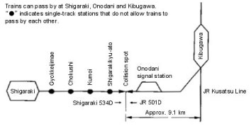

SKR is the 14.7-km single-track diesel line which branches off from the Kibugawa Station on the JR West Kusatsu line (Figure 1). On May 14, the JR West special express train 501D bound for The World Ceramic Festival left Kyoto at 09:30 after a five-minute delay carrying 2.5 times its normal capacity (716 people). Around 09:44, personnel at the Kameyama CTC Center (Kameyama, Mie), which controls Kusatsu line operations, noticed the eastbound train 501D was behind schedule and turned on the "Direction Priority Lever" (DDL) remotely. The DDL is to be used when there is an eastbound train delay. It is supposed to activate a red signal for westbound trains at the Onodani Signal Station to keep them from departing. This should allow the two trains to safely pass by each other at the Onodani Signal Station. The eastbound train 501D slightly recovered from its delay by cutting the stopping time at stations, and at 10:18, left the Kibugawa Station with a two-minute delay. In the meantime, as the red signal at the Shigaraki Station did not change to the go signal, the westbound train 534D could not depart on time and was halted. At 10:24, without communicating with the Onodani Signal Station, SKR switched to hand signals and had the train depart with a ten-minute delay. However, the device to detect the westbound train's erroneous departure from the Shigaraki Station did not function and failed to change the signal for eastbound trains to red. The signal for eastbound trains at the Onodani Signal Station stayed green. Prior to the accident, on April 8, 12 and May 3, a westbound train had departed when a red signal had been on. The "Faulty Departure Detector (FDD)" then had functioned properly, changing the signal to red at the Onodani Signal Station, and the eastbound train had safely stayed in the escape line at the Onodani Signal Station. On May 14, the eastbound train passed the Onodani Signal Station although the operators, somewhat puzzled, did not see the westbound train to alternate with in the escape line (a "Green" signal means "Move forward aggressively" especially when a train is behind schedule). Around 10:40, the 501D train and the 534D train collided head-on and the crashed cars caught a large number of people killing 42 and injuring 614 others. Due to this accident, the World Ceramic Festival at Shigaraki was canceled. SKR lost five train operators out of twenty and two train cars out of four in this accident. The line reopened on December 8, 1991. |

Photo1.SKR Collision
Figure1.SKR Railroad Map
