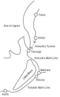

    | Location | Hokuriku Tunnel |

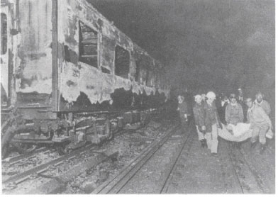

    | Incident | The late night train "Kitaguni" bound for Aomori from Osaka caught fire while the train was in the 13,870m long Hokuriku Tunnel located in Fukui prefecture. The accident killed 30 people including 1 crew and injured 714. The cause of death was carbon monoxide poisoning, not death by fire. Photo 1 is a press photo of the accident. |

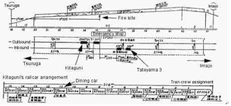

    | Sequence | A dining car in the late night outbound train "Kitaguni" caught fire while the train was in the Hokuriku tunnel. The dining car was the 11th of the 15-car train. At around 1:10 am, passengers reported fire to a train conductor. The train conductor immediately arranged an emergency stop, and at 1:13 am, the train stopped at 5.3km from the Tsuruga Exit (Figure 1). Two of the train crew tried fire extinguishers to stop the fire, but the force of the fire did not abate. The crew then decided to disconnect the burning car and evacuated the train. At around 1:24 am, railcars were separated between 11th and 12th by 60m (Figure 2).
 At 1:29 am, the crew requested help to the exit stations of the tunnel, the Imajo Station and the Tsuruga Station. They attempted to disconnect the 9th and the 10th cars when a power failure on the outbound line brought the train to a stop in darkness at 1:52 am.

 The fire claimed lives of 29 passengers and 1 crew, all died of smoke inhalation. 714 were injured. The cause of death was carbon monoxide poisoning, not death by fire.

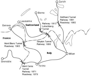

    | Incidental Discussion | Due to the difference in atmospheric pressure, many tunnels have air draft from one exit to the other. A fire in such tunnels induces a chimney effect, multiplying the force of the fire. The long road tunnels in the Alps are equipped with air forced ventilation systems that feed and exhaust air forcefully from the exits to reduce air draft. A malfunction in the ventilation system or an operational error will fail to stop the quick spread of fire, as was seen in the 1999 fire in the Mont Blanc Tunnel. In this 1999 fire, while the French company operating the tunnel maximized the air exhaust power immediately after a transport truck caught fire in the tunnel, the Italian company maximized the air feed power for 20 minutes. As the result, 30 vehicles were burned in the accident(Figure3). |
